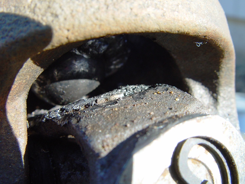

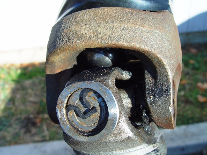

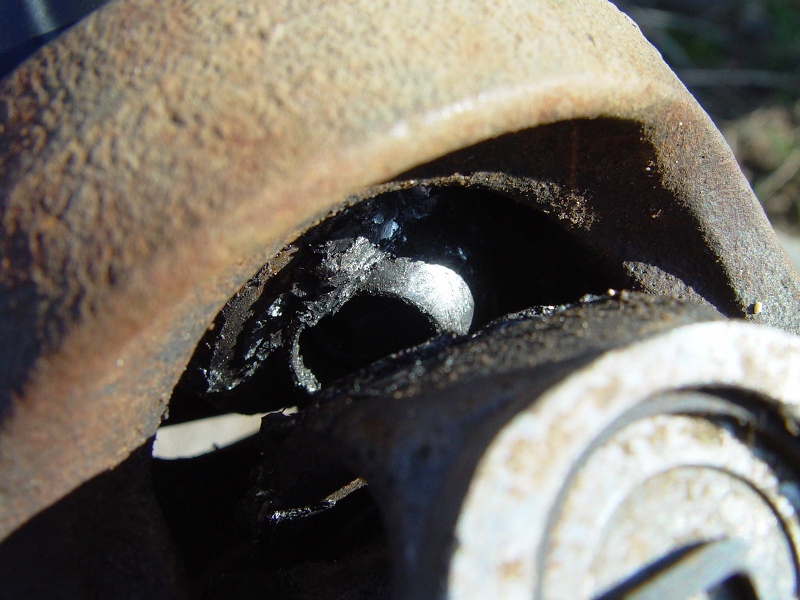

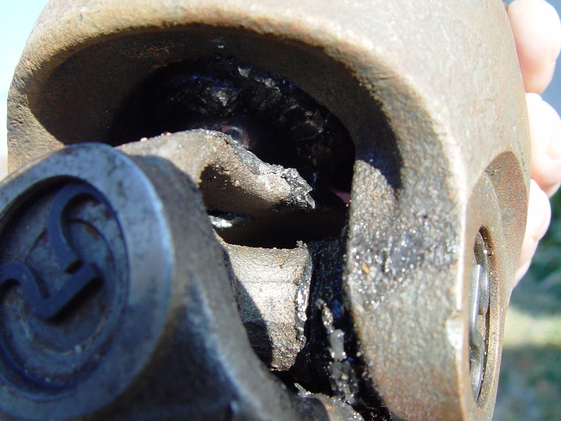

                  I measured it before I took it out and it is sitting at 23 degrees.
                  Here you can see that it destroyed the pin that the ball sits on.
                  I am going to go to a 1330 CV and see if that helps for now...
