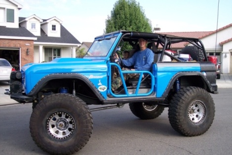

                I am running the aluminum Raceline Monster Beadlocks. 17 x 9.75. Love them!!

                  Yeah, I've seen those wheels wrapped w/ 42" pitbull rockers up close & they're awesome. Think I'll just weld some locks on the 15s for the assembly & look for some nice 17" alums down the road.
                  Thanks guys!
